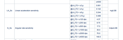

ASM330LHB 6-axis sensor, can it reach 0.001g?
ASM330LHB 6-axis sensor that can reach 0.001g? how high can it reach?
Which 6-axis sensor is more accurate?
Can they both output angles?

Hi @1232 ,
The maximum value that the sensor can reach and also the accuracy depend on the full scale you set according to datasheet:
If you want to reach higher g you can look at LSM6DSV32X that has a maximum full scale of 32g, but not that it is not for ASIL B automotive applications.
Can they both output angles? Yes.
