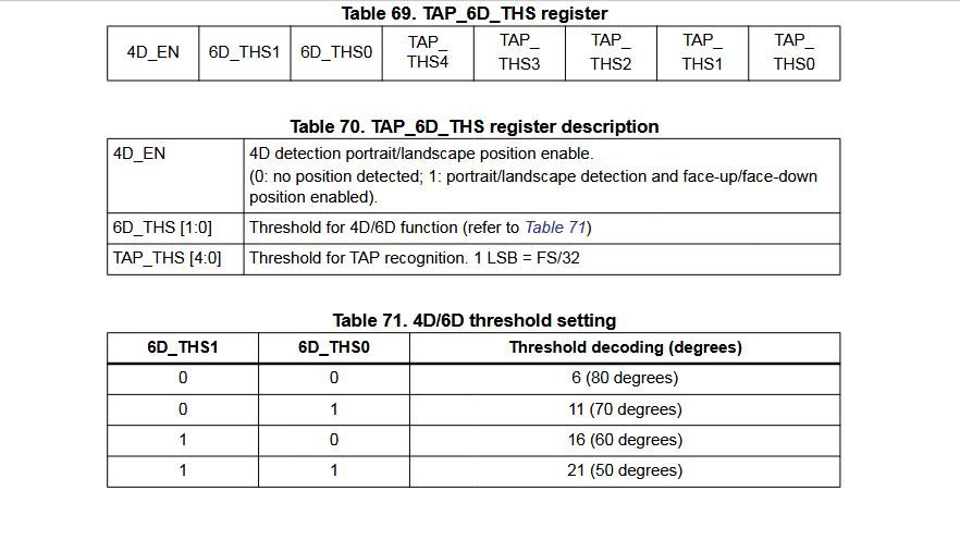

Dear sir/madam,
I'm confused how the Threshold decodeing(degrees) comes like shown in LIS2DS12 datasheet, page 31. When 6 stands for 80 degrees and how 6 comes from?
I try to use 60 degrees threshold and I can read accurate each axis value now, but how can I compare 60 degrees with accurate output values for xyz axis?

    Posted on September 05, 2017 at 09:59
    'Threshold decoding values' are just values used by the internal logic to define the 6D angle, you can ignore them and consider only the value in degrees.
