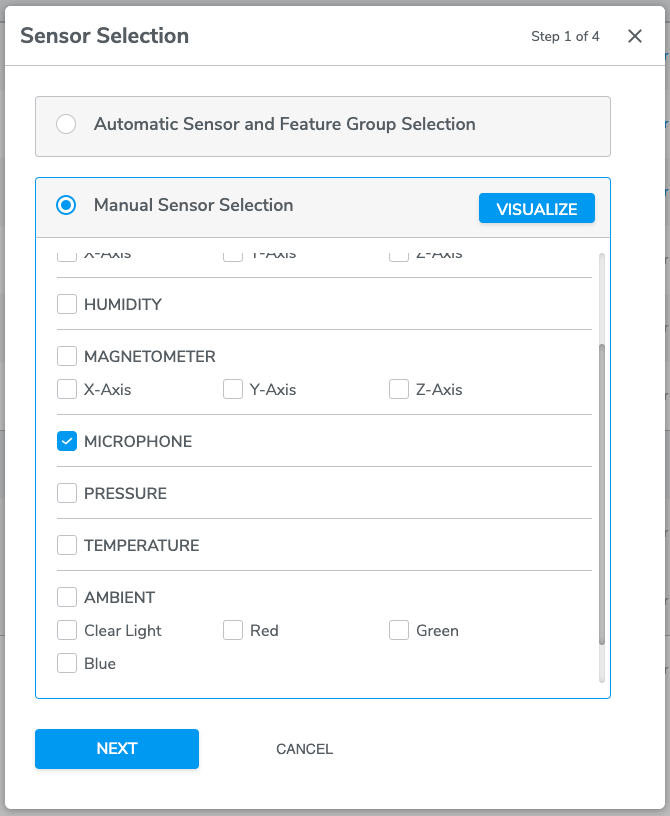

To get started, navigate to the training page and select (or upload) the labeled training data that you want to use to build models for your embedded device. In the Sensor Selection page, you can select the microphone sensor, to choose the collected data, as shown here below:
There is also the possibility to use the automatic sensor and feature group selection, if you want to use additional sensor modalities or experiment with feature subgroups. If this is selected, the tool will automatically choose the sensor and feature groups that make the classes most distinct.

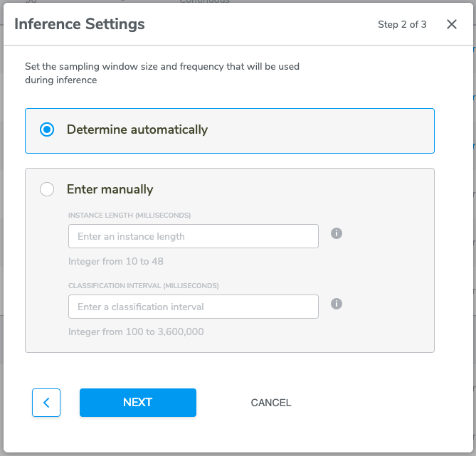

In the Inference Settings page, you can manually set up the instance length and the classification interval, or let the tool determines them by selecting Determine Automatically, as shown here below.

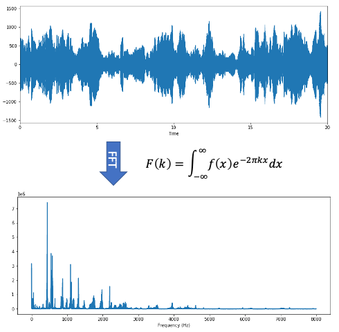

Signals in the time domain are difficult for humans and computers alike to distinguish among similar sound sources. One of the most popular ways to transform raw sound data is the Fast Fourier Transform (FFT). Due to the constraints of embedded devices, the FFT is an efficient frequency decomposition technique. The process is described in the figure below.

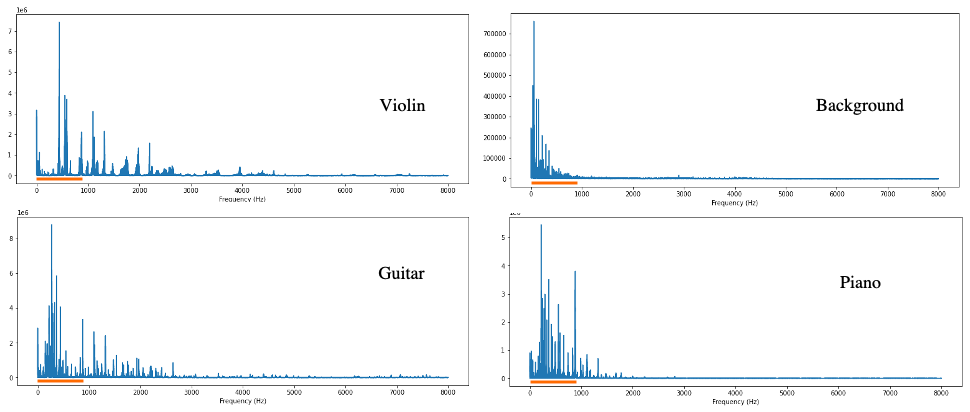

For different classes, the signals differ in their magnitudes for a given frequency bin. For example, in the four pictures below sounds generated with different instruments have different distributions of the magnitudes among the frequencies 0-800 Hz; even with differences present up to 2000 Hz.

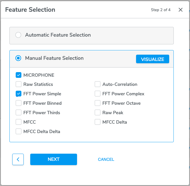

It is a common practice that audio AI training methods will take advantage of the increased class separability in this range to train the model through model training. The most recent audio AI processes, and the Qeexo AutoML tool too, doesn’t just use all of the FFT coefficients as input in training the model, but actually aggregate the coefficients to create sophisticated features. The specific groupings can be hand-picked during the model selection process to accommodate implementation constraints. To select the features groups, simply check the box(es) in the manual feature selection page as shown below.

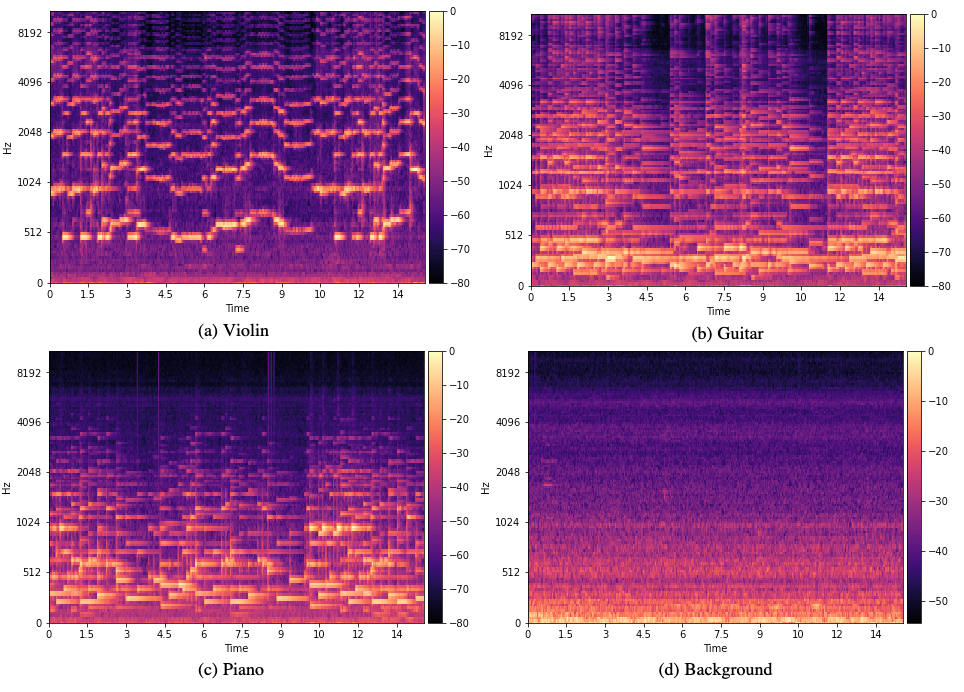

We build a filter bank containing many triangular filters and apply them to our FFT features to rescale the signals again and convert them to the corresponding Mel scales. In the Mel spectrograms shown below, we can see that different classes' Mel spectrograms appear to have many differences, making them ideal inputs for training a classifier.
Qeexo AutoML also provides features generated from the coefficients of MFCC, that can be selected from the above shown manual selector. If desired, you can visualize the selected features through a UMAP plot by clicking the Visualize button shown in the Sensor Selection page and Feature Group Selection page.
Based on this discussion, it should be apparent that MFCC features will work well for tasks involving human speech. Depending on the task, it may be disadvantageous to include these MFCC features if it does not share similarities with human hearing. Qeexo AutoML performs automatic feature reduction, however, when automatic selection is enabled, so this does not need to be an active concern when training models. If the MFCC features are not highly separable for the task, assuming sufficient data is provided, they will be dropped from the final model during this process.
