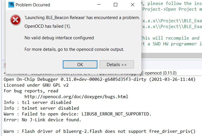

WiSE Studio does not connect to Segger J-Link, although Atollic TrueStudio and J-Link Commander do. Could it be in a different driver? Why different?
I am evaluating the BlueNRG-2 eval board that is working under TrueStudio (that cannot compile an SDK example), but I stopped at non-connecting J-Link.

How does it look in device manage? Any 3rd party filter drivers in the device stack?
2022-08-02 12:35 AM
Thanks, Pavel.
Although I did not fully understand your answer, the link pointed me to Zadig I used once. Switching to WinUSB driver has solved the problem.
Another issue is that J-Link within WiSE setting is not able to halt CPU (any reset mode option) so download/debugging does not work.

Well, since that "WiSE studio" is ST software, let's tag this as bug report.
