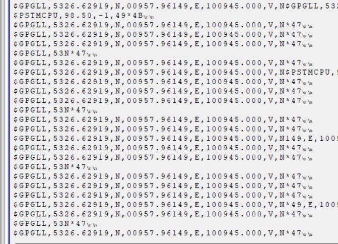

Using AEK-COM-GNSST31 board with the Teseo Liv3f GPS on. I have successfully accessed the data from the gps but I want to recieve only $GPGGA, $GPGLL and $GPRMC messages. How do I do this ?

I tried using the $PSTMNMEAREQUEST command setting only the bits for the 3 messages but I am still getting the periodic messages.

    Yes, the device is definitely responsive because it prints my requests and other data as seen in the photos below. Wiring, UART and checksumm are I suppose and CR,LF also present.
    • For checksumm I am using an online NMEA checksumm calculator.
    • Commands in my code are like this - for the GPGLL msg "$PSTMNMEAREQUEST,0x100000,0x0*7D\r\n"
    Here is the output of my code

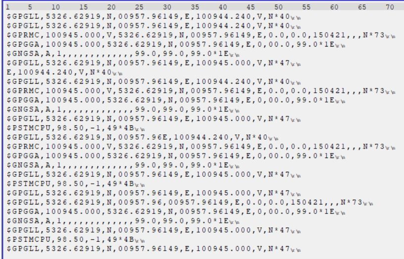

    0693W000008zfhUQAQ.jpgAs you can see it is responsive and the GPGLL is printed upon request, but every period it gives a lot of other data like in the next photo.
    Is there a way/command to stop any other message except the requested ones ?
    Thanks !
    Your buffering of the USART data appears borked.
    Shouldn't be missing characters and lines randomly.
    Perhaps implement an IRQ based buffering scheme, rather than polled, and have a deep enough buffer.
    Copy the data out of the live buffer (changing under IRQ) if you're storing a line at a time.
    G. Michael
    April 16, 2021
    Thank you for your help,
    I adjusted the buffer and the messages are not being Cut randomly.
    I solved the issue with the specific messages using the $PSTMCFGMSGL instead of $PSTMNMEAREQUEST.
