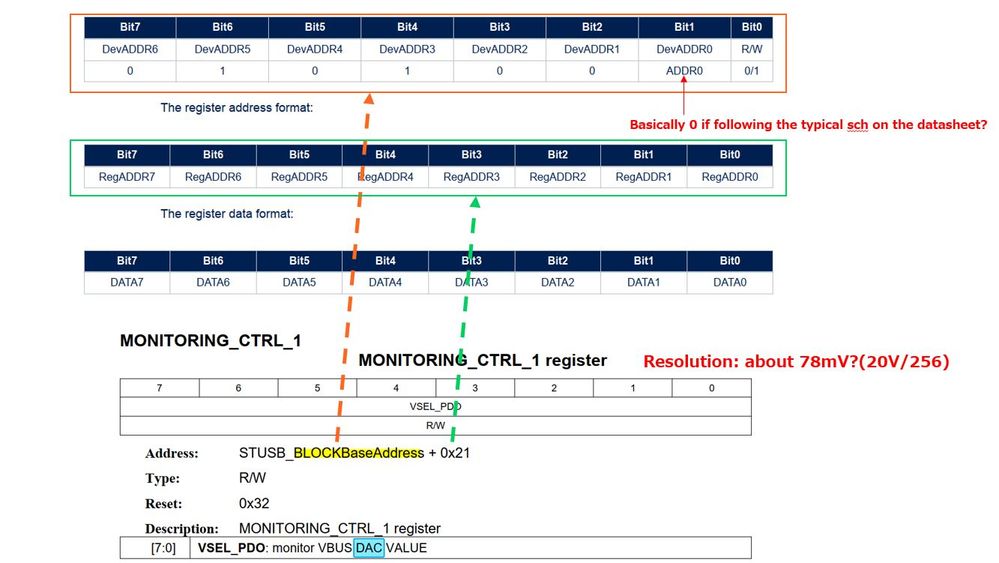

I'd like to confirm the register-address details of this STUSB4710(4700). I found the post related to the register-address below and looked over the document. However, kinda struggling to understand it fully.
1: Does STUSB_BLOCKBaseAddress mean the device address in the datasheet?0693W00000Lw5SjQAJ.jpg2: How do I calculate the actual DAC value on VSEL_POD? I'm assuming that the resolution would be 78mV( 20v divided by 8bit)
I might be able to supervise the output voltage in another way, but it would really be helpful if the register in the STUSB4710 works.
