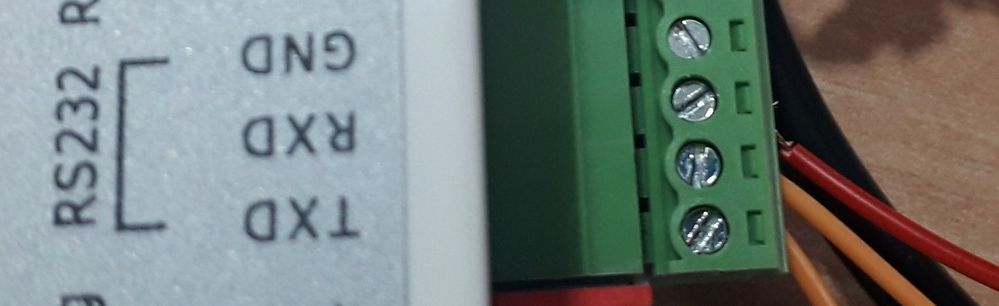

Thank you so much for the help @Community member​, so i will use a RS232 transceiver (MAX3232) to read data from my device. After connection of :
RX_stm32 --> TX_MAX3232
TX_stm32 --> RX_MAX3232
now should i use a normal UASRT configuration to read the data or configure the USART of the stm32 used with the Hardware flow control RS232 option ?
this a picture of the RS232 pins of my device :0693W00000Hr7diQAB.jpg
mƎALLEm
January 10, 2022
@BMoha.3​ ,
As I already said, you can use UART or USART for RS232 communication.
USART can be used also for synchrounus communication but you don't need this feature as per the picture you shared.
You can refer to any of the examples provided in STM32CubeF4 under the path:
\Projects\STM324xG_EVAL\Examples\UART
