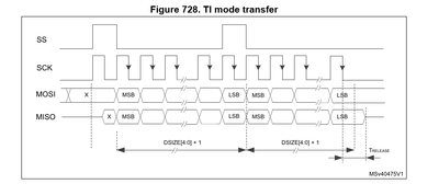

I am using Spi with Dma. When using the Hal-function "HAL_SPI_Receive(SPI_HandleTypeDef *hspi, uint8_t *pData, uint16_t Size, uint32_t Timeout)", I want to receive 1000 times Data , which I can set in the size-area. The Problem is that my Spi-peripheral needs constantly Cs-pin to get set and reset to give out Data, else i receive after one usable data just zeros. My question is following: Is there a way to tell the Spi to set and reset the cs when data gets received, and if so, how, or where can this be configured? I am currently using the function in a for loop to receive my Data with the size set to 1. But this is way to slow. Thanks for Helping.

The Problem is that I have to redo the function in a for, or while loop is that my SPI-Peripheral needs for every data to be send a CS high and low, or else the ADC does not get the information for giving out data. Thats why I want to find out if threr is a way to set CS high and low every time a value gets transmitted, when getting 1000 Bytes by calling this function only once.
still no info, what cpu you use ...
ie on H563 u could use TI mode : (if this is, what you want)
SS = CS output
What is the problem with setting CS low before HAL_SPI_Receive and high afterwards? I don't see how being in a loop is relevant here. Surely controlling a CS pin works as well inside of a loop as it does outside.
Hi, the Problem is that when I set Cs high and low that only one data is transmitted because the Peripheral is build so. Thats the reason i am asking if there exist a way to configure the stm32h723zg in that way, that if a value gets received the cs gets automatically gets set high and low, so the ADC can give out the next value. If I set the CS low than expect lets say 1000 values and set cs high again, I only get one value and 999 times zeros. So thats why I am using the receive-function in a while loop to receive enough values. So is there a way to set cs automatically while this function is ongoing? Thanks in regards

So I could solve the Problem. It is simple as that. I am using the NSSP mode wit 2 cycles in Master Inter Data Idleness
