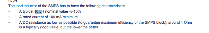

We want to use the S2-LP with embedded SMPS enabled. The recommended inductor value is 10uH.
We need to lower the inductor value. I have read  that it would be possible to reduce the inductor value to 2.2uF in  the AN5246
How to use SMPS to improve power efficiency on STM32WB MCUs
https://www.st.com/resource/en/application_note/an5246-usage-of-smps-on-stm32wb-series-microcontrollers-stmicroelectronics.pdf
Would this be valid also for the S2_LP transceiver?

no 2.2µH coil can NOT be used for S2LP transceiver SMPS block. It is not the same design than WB MCUs.
You MUST follow the characteristics described in S2LP datasheet:
regards
