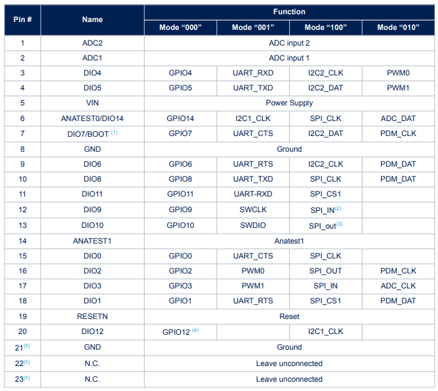

I wonder how to connect the pins of this module as it has a very form factor.
For example, it has an expansion board?

Please refer to datasheet: https://www.st.com/resource/en/datasheet/bluenrg-m2.pdf
The pin connection for BlueNRG-M2SP would be:
You may program BlueNRG-2 through either UART bootloader or SWD (ST-Link) for customized applications,
configuring the IOs for function needed.
