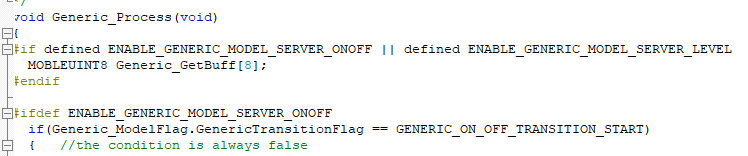

Hi Sir: I try to use my Android phone to control a led's on-off-status. Now my phone can connected with my Development board, but when I control the led server it has no reactions. The condition is false.

Are you using the latest SDK on an ST EVAL board ? Kindly specific which board you are using ?
Also, latest Android app is used ?
Kindly check if during the provisioning, the binding to Generic OnOff Model was done or not ?
Hope the "Vendor Model" is not enabled from the menu on the left side of the App. If yes, kindly check to bind the Vendor Model please
