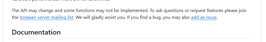

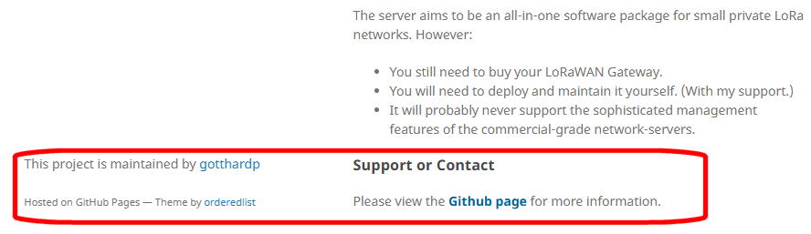

Note that the server is a 3rd-party open-source project - not an ST product:
So that would be the place to get support for it:
https://github.com/gotthardp/lorawan-server
