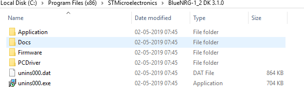

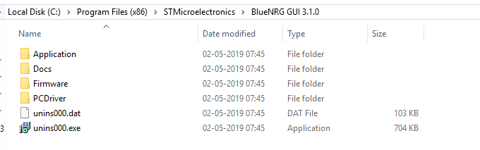

I tried installing the package "BlueNRG GUI 3.1.0" and I faced certain issues during its installation. First one, there was an issue in driver installation.
 I am using the STEVAL - IDB008V2 board. But the main issue is with the installation itself. If I notice the directory in which it got installed, there are no projects or library files.
There is no way for me to open a project in Keil either.
I encountered the issue even when I try to install this in different computer with different OS (WIndows 10 & 7). Any suggestions will be helpful. Thank you.

Hi rdscliff,
I have installed both the packages with administrator rights. It has to do something with the digital signature I guess. The main issue here is not the driver but the missing files.
As you can see, I have installed the developer kit and there are no project or library files.

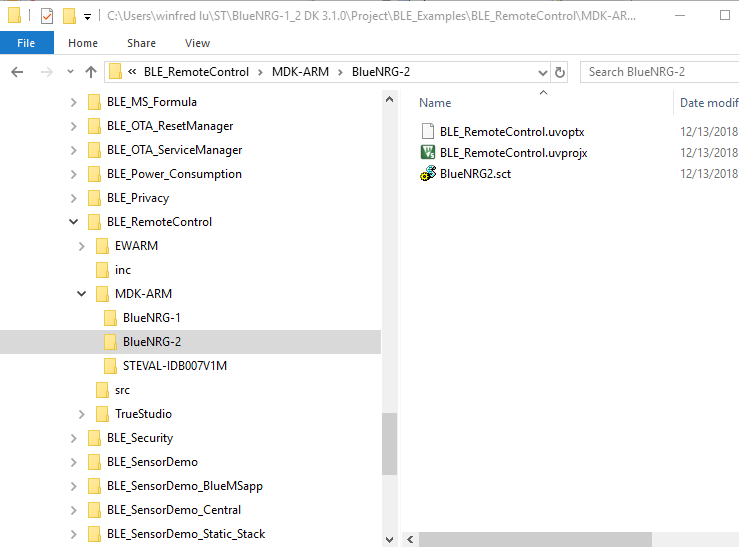

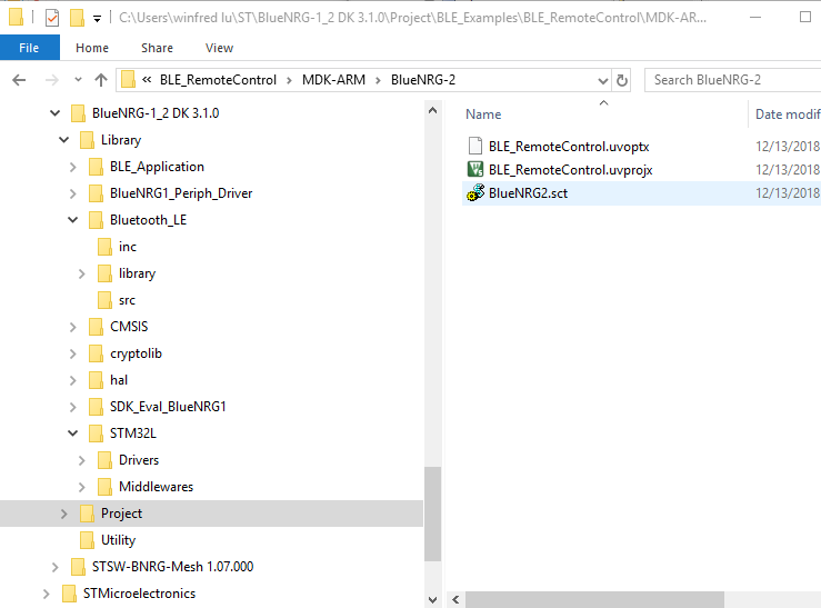

Hi Naveen,
The project files are under C:\Users\<ID>\ST\BlueNRG-1_2 DK 3.1.0\Project
As stated in Release Notes,
  • Library, Project, Utilities folders are located under {User} –> ST in order to be able to directly compile projects even with Windows User Account Control activated.
Best Regards,
Winfred

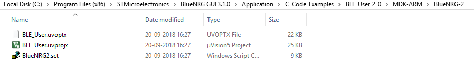

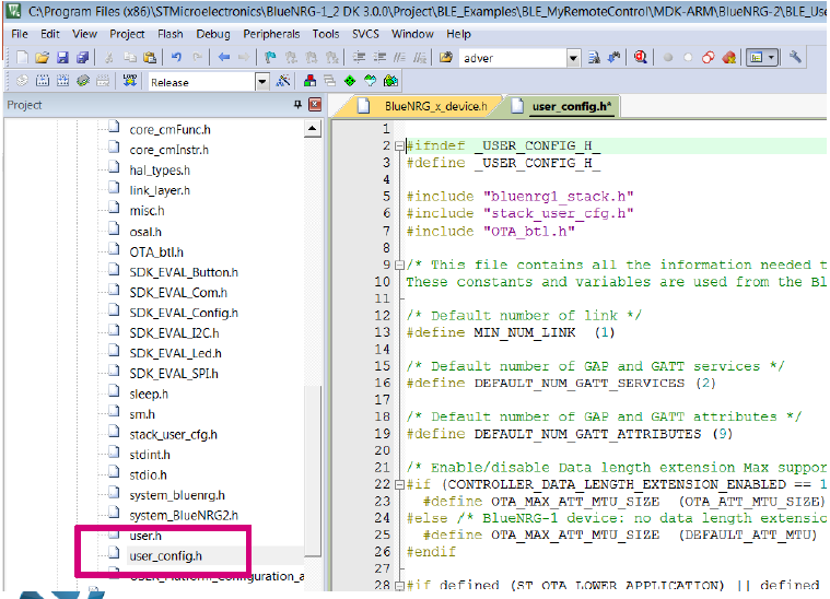

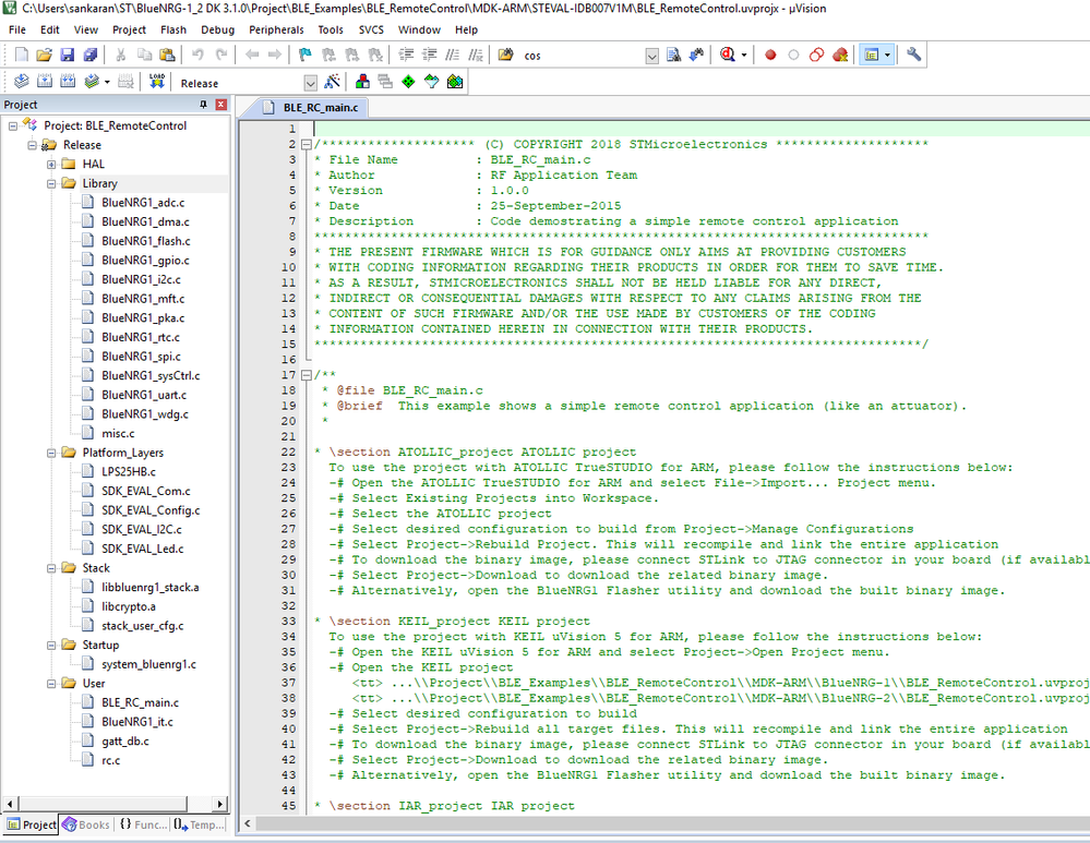

Thanks for the reply. But that just answers first half of my question. I still can't find certain files, which are required to completely open them in Keil (for example). I encountered the same issue during the workshop conducted by ST. Let me show you something for better understanding.
This is the image from a slide that was presented during the workshop. The project clearly lies inside program files directory, which may have misled me. But, the project contains all the necessary files to start in the first place. I am missing those, which can be seen in the image below.
As you can see from thea above image, I am clearly missing the files which were listed in the image from the workshop. I asked the same question there, but they just gave me a portable version of the installed package.
Thank you for the reply.
Thank you Winfred. But the major problem is the missing files, which I have mentioned below. Thank you again.

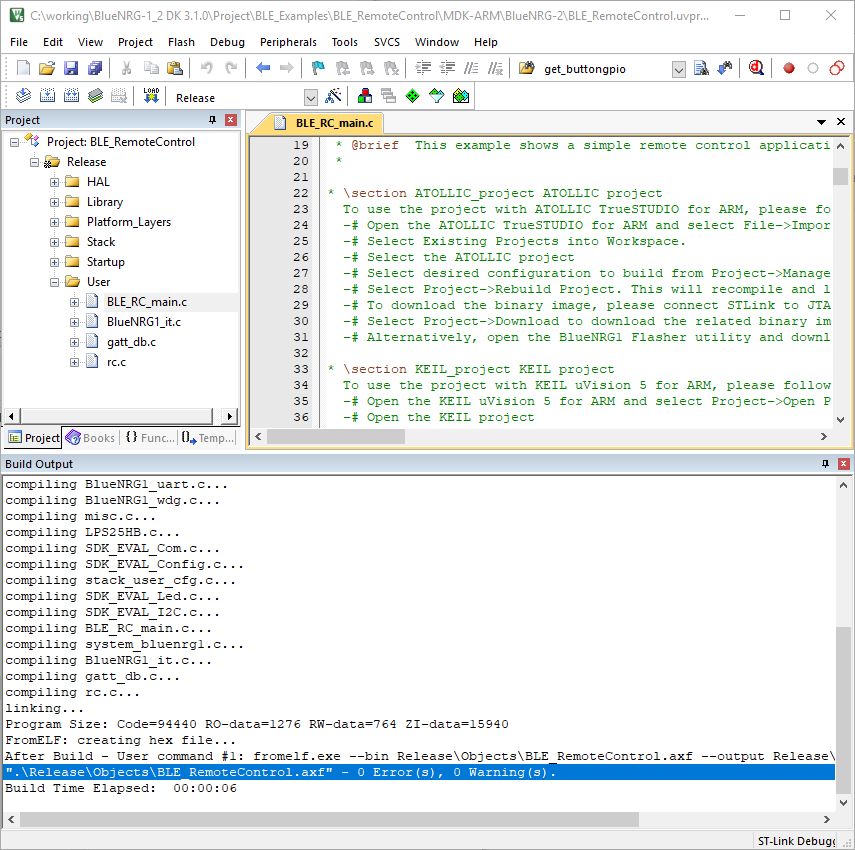

Hi Naveen,
Not quite understand the question. Which files are missing?
All the project files that come with DK shall work without needing to add files.
All the required files have been in  C:\Users\<ID>\ST\BlueNRG-1_2 DK 3.1.0\Project
Compile BLE_RemoteControl project with Keil MDK-ARM successfully:
Best Regards,
Winfred

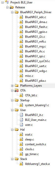

Hi Winfred,
Please have a look at the image from the workshop that I posted. It contains files such as user.h, user_config.h to name a few, in its project folder. Am I being misled by that image or I am missing certain files to run the evaluation board STEVAL - IDB00BV2 ? I am required of the APIs that are used inside the BlueNRG GUI, for example.
Hi Naveen,
For missing user.h or user_config.h of the project used in the workshop, please request the original provider.
To use with BlueNRG GUI, please flash IDB008V2 with DTM binaries.
