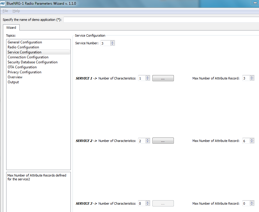

adding service return 0x1f error

Hi Aqib,
Return value 0x1F means 'Out of memory'.
Possibly you need to increase the memory size to be allocated (mblockCount) in
BlueNRG_Stack_Init_params structure.
The size should be increased according to the number of services and attributes you'd like to add.

‎2018-02-20 4:18 PM
how to find out the correct size of mblock to be initialized for adding services?

‎2018-02-21 8:37 PM
Hi Aqib,
Please try the BlueNRG-1 Radio Parameter Wizard, which comes with BlueNRG-1 DK.
In topic ''Service Configuration'', config the needed number of services, characteristics, and attributes,
the reference size will be exposed in ''Output'' topic.
The thread mentioned by Antonio will be a great reference.
