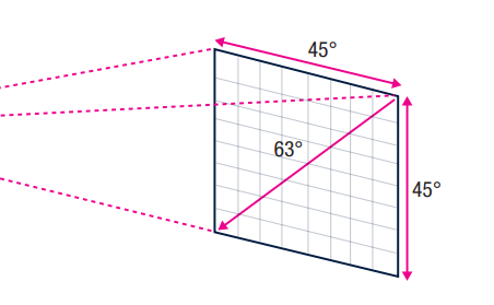

What is the maximum and minimum exposure area in m² of the VL53L5CX in 8x8 Mode?
MaikH
Hello STCommunity,
I can't find some data about the exposure area in m² of the VL53L5CX ToF-Sensor, there is only the FOV in degree mentioned in the flyers and datasheet, as you can see below.0693W00000QKDdUQAX.pngI look forward to hearing from you.
kind regards
Maik H.
John E KVAM
The easy way to think about this is that at some distance N, the area of illumination is NxN.
So at 30cm away from a wall, the effective field of view is 30cm x 30cm.
And with the sensor 1M from the target the FoV is m².
To be sure there might be 'splash' as only the FoV is fully illuminated. The area around the edges will still be illuminated, but to a smaller degree. And within a few degrees the light falls off.
