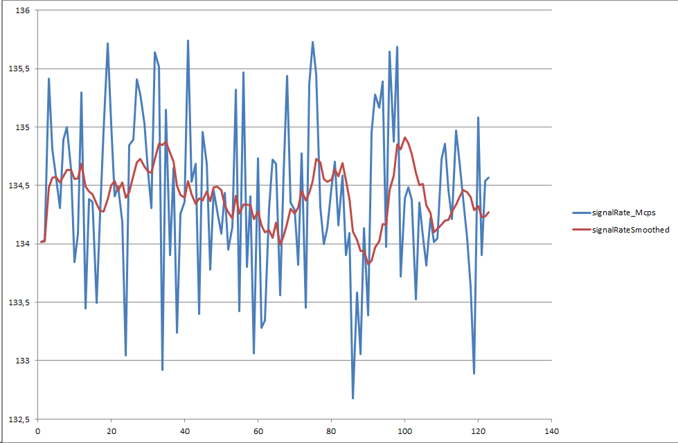

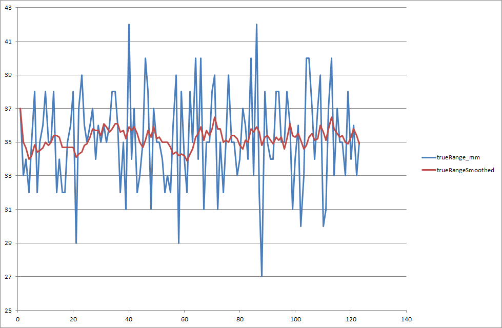

Jan Wustrau
I tried it with white paper, in open air (als = 20, distance = 50 mm) and also closed together in black box (als = 0, distance = 35 mm).
Now i connected sensor to your gui app, please find results below (als = 0, distance = 35 mm).
RangeSmoothed looks very good - this is what i want. With small mean function it will be enough for me.
I have read, that TrueRange is read from register 0x62 and smoothed is raw result read from 0x64 (without cross talk compensation). Is it right?
Maybe problem is in cross talk settings? Now i don't have any glass cover, but i also tried with it before (of course with proper calibration).
John E KVAM
If you don't have a cover glass, and you don't have an obstruction, then you don't have crosstalk. Cross talk is a condition where photons short-circuit the system and reflect back to the receiver without going out into the world.
Photons are really fast. 6.7pico secons per mm round trip. You cannot get that kind of a measurement in a tiny, inexpensive chip. (A pico second is a millionth of a millionth of a second.) Heck you can't to that with an expensive scope.
So we use statistics. And what you are seeing is the variability in those statistics.
If I told you that you would be getting 134mm +/- 1.5 I think you would be happy. Your results are actually better than our datasheet says they will be.
(By only looking at one target refectivity, you results are fine.)
If you have the time to take a lot of measurements, you can average them together as you have done with your smoothed line. But the sensor can do that too. By using a longer TimingBudget, you are gaining accuracy. 4X the TimingBudget generally equals 2X the accuracy.
