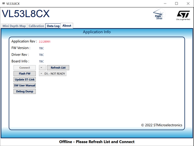

I have P-Nucleo-53L8A1 EVK. This board is connected to PC via micro USB cable.
LD1 and LD3 LED's are ON and are red in color.
I am trying to use VL53L8CX GUI , but its showing at About window as attached.
'Update ST-Link '  process tried. LD1 was blinking with Red when this process was happening.
But, even after that same window getting.
How to resolve it???

The devilish side of me would say click the button 'SW User Manual', but you are not the first person to get stuck here.
Click 'Refresh List'. This will go out and find all the STM32F401RE's you have attached.
Then pick one - perhaps you only have one?
And 'Flash FW'. This will dump the code into the STM32 that translates your commands into what the sensor needs and it returns the data.
Then click 'Connect' and the channel will open.
At that point the 'Mini Depth-Map tab is become active.
Click that, hit start and you are all set.
Good Luck.
And if you get a chance, go back to the about tab, and click on the User Manual. Good stuff in there.
