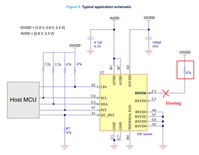

MFabb.1
April 28, 2023
Hi John,
VL53L5CX does not have a pin dedicated to XSHUTDOWN line (as seen on VL53L0/L1).
Is the XSHUTDOWN signal masked as a reserved pin (RSVD6 or RSVD5) or I2C_RST pin?
Eventually, could glitches on the I2C_RST be the cause of I2C transaction errors?
We also investigating some issues on the I2C communication between host and VL53L5CX.
Thank you

John E KVAM
November 15, 2023
C2 is a Unused GPIO. It's an output so just pull it up gently and ignore it.
You aren't going to use an significant amout of power.
And could you start a new thread when you have a different question please?
It makes it easier for others to see the answer.
