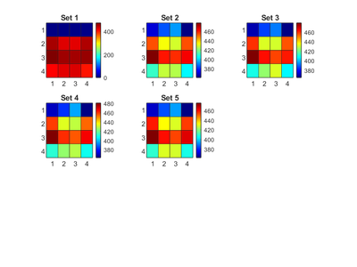

Even in the SparkFun product introduction video (2.45-3.00 min), the representative presentation shows there is some bouncing in the sensor reading. I have also experienced the same bouncing issue. How can we deal with this problem?

‎2023-12-05 12:43 PM
Hello @Anne BIGOT ,
Thank you for your response, but what I meant is not flippers. As shown in the video, there is significant bouncing in sensor readings. t
Besides, I have attached a plot that shows five subsequent readings from the sensor. The readings do not make any sense to me. I am wondering why the first row gives a value close to 0.
