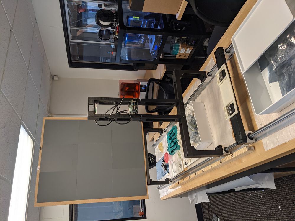

Our other problem is xtalk calibration procedure itself. With our coverglass, we get "near ideal" ranging performance out to 100 cm, and we don't need anything further than that... so this does not call for xtalk calibration. Any time we add a comp rate, it worsens performance. However, the problem is that when a smudge is placed on the coverglass, all bets are off; performance nosedives.
How should we determine what Xtalk comp rate to use for RIT when, actually, we normally are better off without enabling a comp rate in the first place?

Hi John,
Thanks again for the quick reply!
Yes, we also started doing business with Hornix (and Giovanni from Gilisymo) this week and ordered their dual-window coverglass.
We tested the dual-window design and are excited to transition, however, all of our current inventory and units in the field / sold to customers were built with the old coverglass. We are trying to make the best out of those existing builds by deploying a software update featuring RIT and anything else that will help mitigate smudge crosstalk noise.
I can continue investigating software solutions here, but I wanted to see if we can get an authoritative clarification on how RIT should be configured.
