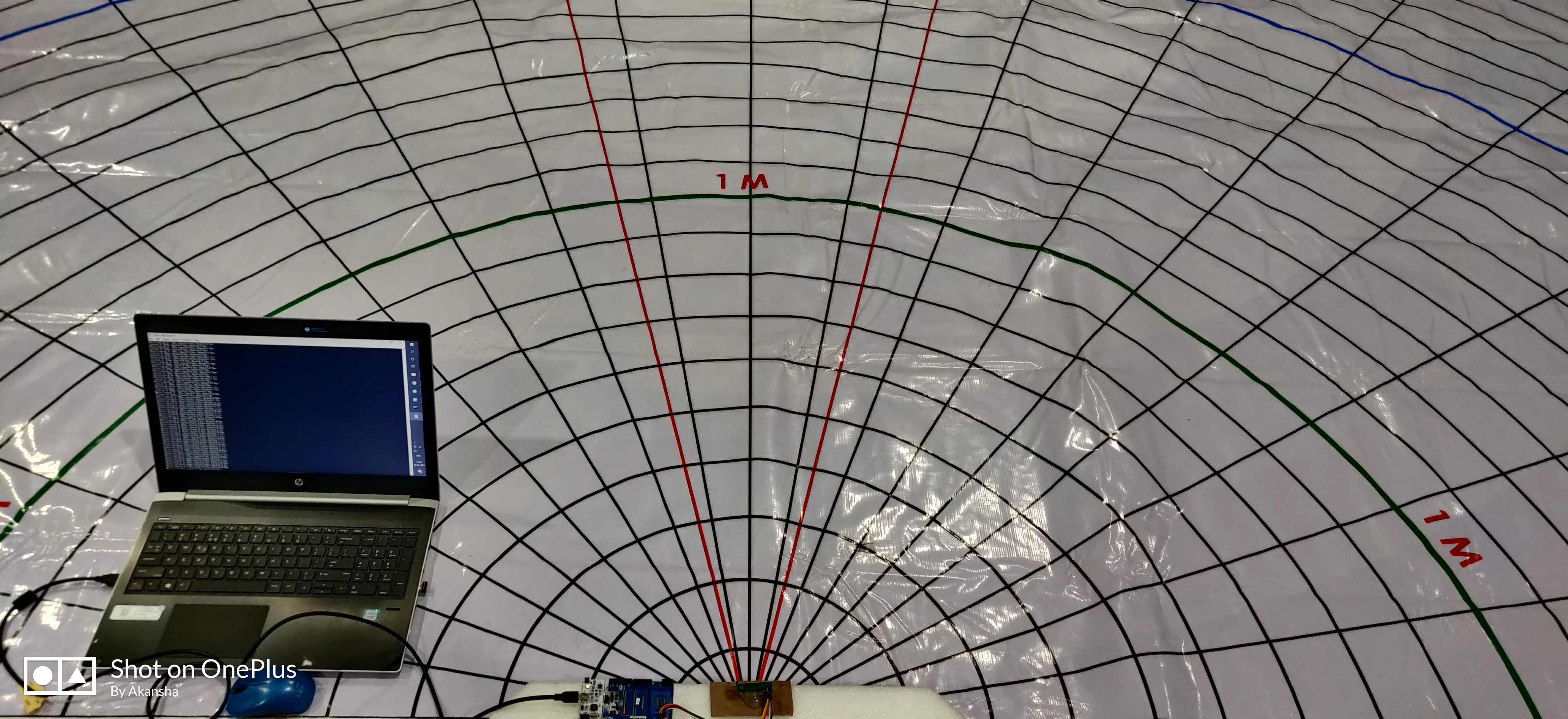

I am working on VL53L1CB sensor for designing Obstacle detection sensor.
I have tested with accuracy and range of sensor.
I am encountering the problem of random ranging when there is no target in front of sensor.
I kept the sensor at height of 15cm from base and there is not obstacle in front of it within FOV of 27 degree. Still, it is showing ranging distance varying from 850cm to 1200cm sometimes.
I am not getting weather this is the case of ground detection or there is any other reason.
Please assist me dealing with this

Akansha
AkanshaAuthor
January 15, 2021
Hi ,
I am attaching test setup of sensor. I kept the sensor at the height of 10 cm from ground and obstacle were placed in front of the sensor over flex sheet.
  1. I meant that sensor was placed at the height of 15 cm from ground and there was no obstacle in front of it, Still it was giving the ranging distance in range of (850 - 1200)mm. By mistake i have mentioned the unit cm.
  2. No, Sensor doesn't have any cover glass while testing.
  3. I am attaching log file for your reference.
  4. Sensor was placed on the flex sheet (PVC material). Snapshot of test setup is attached below.
Log File
Regards
Akansha

John E KVAM
January 29, 2021
The calibration does not affect the range, it affects the accuracy of the range.
But I think I see a flaw in your experiment.
If you take a piece of paper and fold in diagonally you get a 45 degree wedge. Fold it again and you will get 22.5 degrees. Then place it in front of your sensor. This will give you a very rough idea of what is in your Field of View (FoV).
A 27 degree FoV has a diameter of about half the distance.
So at 30cm the FoV is now 15cm in diameter. At 60cm the Fov is 30cm in diameter.
if you sensor is 15cm above the floor, you will start to see the floor.
and you will start to see a return signal from the floor after that.
using the piece of paper as a guide slightly tilt your sensor upwords. At some point you will no longer see the floor.
In my 2D lidar video https://youtu.be/BMR-IPMGJSE I use this approach.
The video uses the VL53L1X, but the video shows the slight upward tilt you are going to need.
