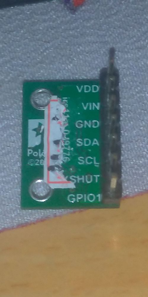

Hello , I need to use 2~3 vl53l1x sensor breakout(from pololu)
with nodemcu32s ,use arduino ide ,

Q1:
Where should i put the SetDeviceAddress
should i just define VL53L1_Dev_t dev ,Dev =&dev ?
I really need to use this api because​ i need threshold function and ROI function
Can you modify my code?
Q2:
How to connect pins
I use 21 22 pin (Original SDA SCL on esp32) ,3V3 and GND
how should i connect wire ,need connect xshut pin if i want use multi sensor??

​In theory the answer is simple.
Connect the reset lines to MCU output PIOs.
Put all sensors in reset.
Then take the first sensor out of reset.
Issue the command to change it's address.
Then take the next sensor out of reset and change it's address.
Repeat as often as you need.
I'm using 9 sensors and have no issues.
(I even change the address on the last sensor - so if any of them reset due to noise on the reset line, they will answer to the original address, and I will know I have an issue.)
In your code, create several Dev structures ( Call them Dev1, Dev2... or you create an array of structures.)
Have them all defaulted to I2cDevAddr = 0x52.
After issuing the command to change the address, update the I2cDevAddr to the new address.
and that should do it.

A possible alternative if the sensors must stay up and running would be a SW I2C with different SCL (or SDA) lines (will cost same number of signals as VL reset lines.
