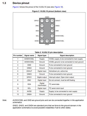

Is it possible to control the VL53L1X ToF sensor using the stm32f407?
SugengGod
Is it possible to control the VL53L1X ToF sensor using the stm32f407? because I am looking for the average website using the nucleo board.
STTwo-32
Hello @SugengGod and welcome to the ST COMMUNITY :smiling_face_with_smiling_eyes:.
Yes, it should work perfectly. You should take care of the pins wiring refer to the pin decriptions:

Where did you get that photo from? oh yeah is there a complete tutorial or something without using the x cube module?
