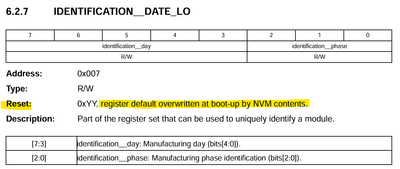

The NVM holds some configuration values. They are retained for the registers that the datasheet says they're retained on, which is not all registers. For example, here is one register that is retained:

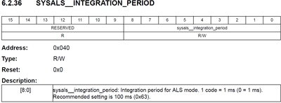

Even if I write a value of 0x60 into a register, such as 0x040, it resets to the default value after power cycling. I can't find any software process that overwrites this address. I've tried all register addresses and they all get overwritten. I would like to ask if there is a way to permanently write to a register without it being overwritten.
Thanks in advance.
For register 0x040, the reset value is 0x0. There is no way to change this.
