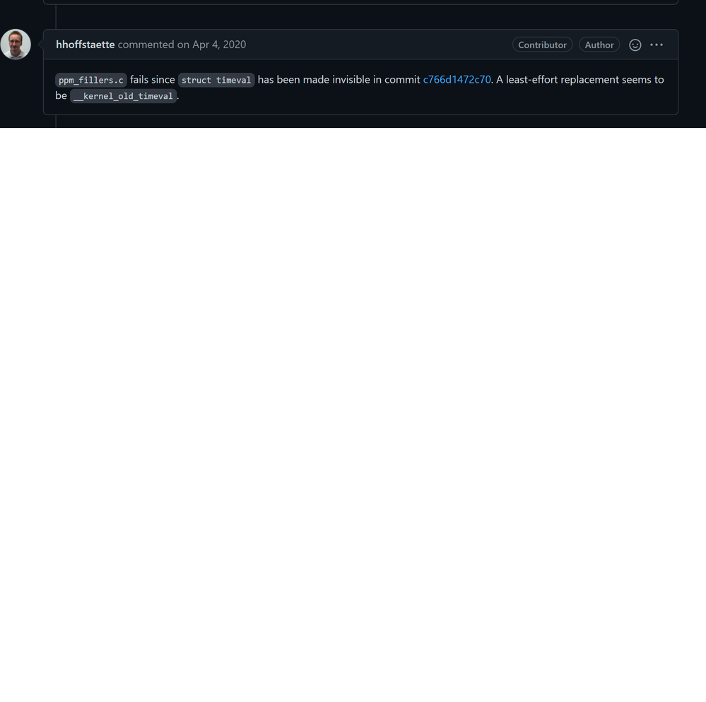

0693W00000DmaMQQAZ.pngSeems there is a known problem compiling struct timeval with 5.x kernels:
https://github.com/draios/sysdig/issues/1609
I'm going to investigate what to do about it. I have not run across this before.

Well it sure looks like you were right.
And it took my team a bit to solve it.
They had to rework a bit the deprecated timeval structure to make it work in both old kernel and 5.10.X
I2c_new_device function has been deprecated too, the modified files use i2c_new_client_device
Future releases will include these changes
