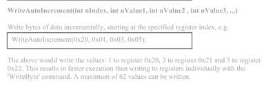

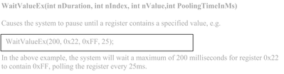

Sure. Here is a script you can use to initialize the sensor. It configures the sensor registers using the following commands:
Regards, Megane
