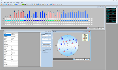

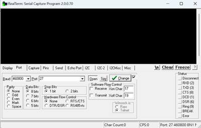

I am able to receive data normally when connecting USB with Teseo Suite, but when I connect using Terminal software, there is no data output at all. I am sure the baud rate is 460800. Is there a specific command I need to input for it to start outputting data?
I am using "Teseo EVB".
The connection with Teseo Suite is normal, and the data output is also normal:
However, when I use Terminal software to connect, there is no data output at all:

Teseo-Suite doesn't raise any command against Teseo-V to get it working.
Just because Teseo-V is powered it will works.
Please check on Terminal the baud rate and COM port and enable the Display has 'Hex' value.
