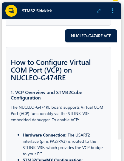

See:
https://community.st.com/t5/stm32-mcus-boards-and-hardware/struggling-with-a-simple-uart-printf-on-nucleo-g474re-works-on/m-p/874056/highlight/true#M29428
Sidekick says UART2, but the User Manual & Schematics show LPUART1 (default) or UART1 (by changing solder bridges):

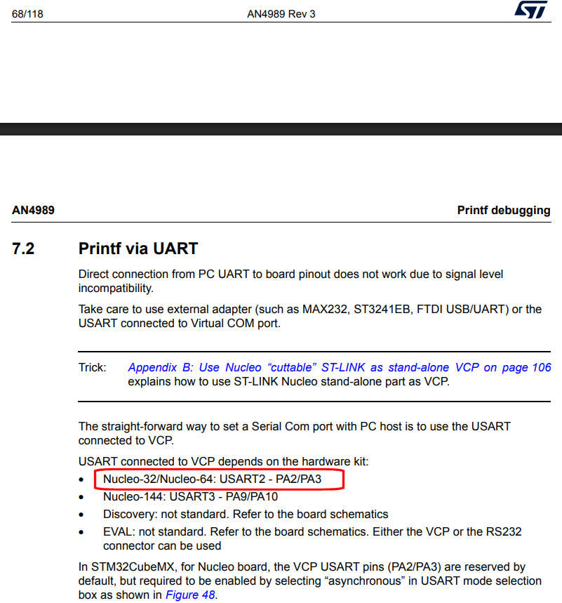

@STOne-32 says here that the incorrect answer comes from out-of-date information in AN4989:

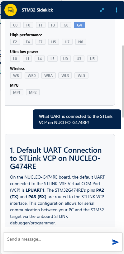

IF, instead of just "NUCLEO-G474RE VCP", I ask, "What UART is connected to the STLink VCP on NUCLEO-G474RE?" - it does give the correct answer:
It still gives the wrong answer for the original question:

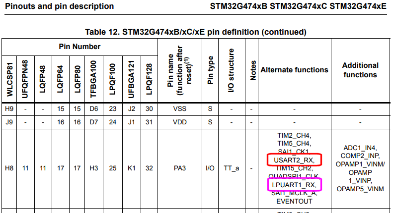

USART2 *can* be used at that Nucleo at PA2/PA3, too.
So it can:
