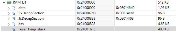

SDosh.1
SDosh.1Author
February 12, 2021
Thanks for your suggestions!
I've tried statically allocating the buffers as global variables, but the same issue occurs.
I've also tried increasing the stack size, and no matter how large I make the stack/heap (see images below), the exact same hard fault issue occurs.
Are there other suggestions as to what may be causing the issue?
