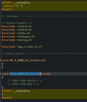

It seems like a used ram size fit to External SDRAM in STM32H757i- EVAL Board.
However, I can see the error when doing analyze.
Also, I cannot see any TFLite Micro runtime generated code.
I can see empty function.
I was totally fine with STM32CUBE AI runtime.
2024-08-26 3:17 AM
You have to select the Template code, System performance application or Validation application to have code generated in those sections
2024-08-26 11:39 PM
I selected the Validation application.
I was wondering if TFlite model Used Ram: 1.29MiB, then MCU need x10 size RAM?
It is showing that 1.29 MiB. However, 8 MiB External SDRAM is not enough.
