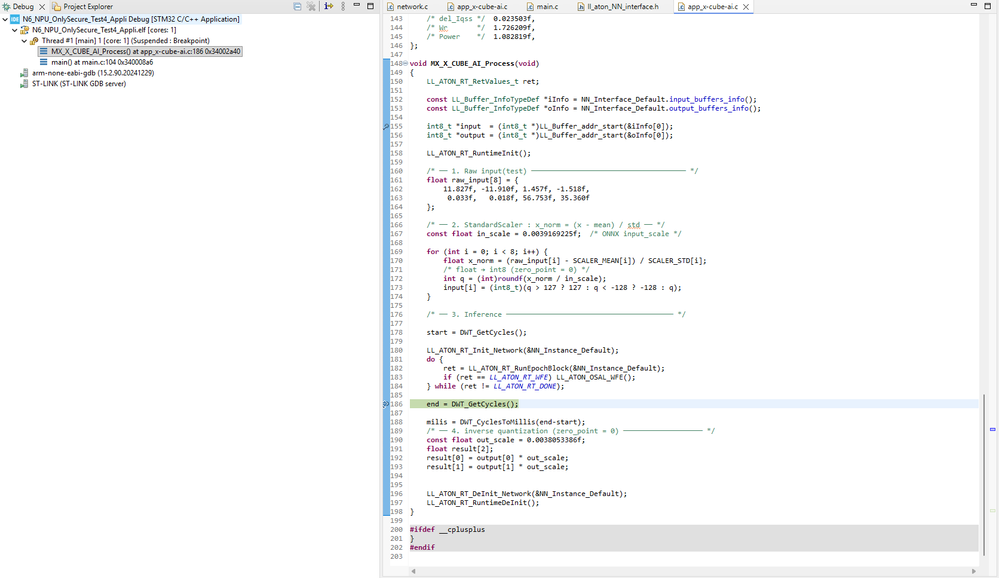

I am currently experiencing difficulties using the STM32N6 NUCLEO board.
My goal is to test NPU execution using X-CUBE-AI within CubeMX. However, I am stuck in an infinite loop inside the MX_X_CUBE_AI_Process function. Specifically, LL_ATON_RT_RunEpochBlock() continuously returns only the LL_ATON_RT_DONE status, preventing the loop from terminating as expected.
do {
ret = LL_ATON_RT_RunEpochBlock(&NN_Instance_Default);
if (ret == LL_ATON_RT_WFE) LL_ATON_OSAL_WFE();
} while (ret != LL_ATON_RT_DONE);
I Can't get the LL_ATON_RT_DONE, only LL_ATON_RT_WFE.
This issue persists even when using files generated via Cube AI Studio.
I have configured the AXI and Clock settings in CubeMX (CPU: 600MHz, NPU: 800MHz, AXI: 800MHz). Since the model is simple, I am using internal memory only and have not enabled any security (TrustZone) or external memory settings.

2026-03-31 2:25 AM
Hello @Student_0726,
I don't have any issue doing so with the debugger, with STM32N6570-DK and NUCLEO-N657X0-Q.
On your side, are you working through the debugger or through loading scripts?
Is your board having correct power supply ? You should have the a green color in led LD4. If it is orange, it means the power is not sufficient.

2026-03-31 4:04 AM
@hamitiya Thank you for the reply.
I checked your feedback and tried running it again—now it passes through correctly!
I was testing in the CubeIDE debug environment, and the LD4 green LED was on as expected.
Honestly, I’m not sure why it’s working now, as I haven't changed any code and the USB connection wasn't unstable before. It’s a bit mysterious why it was consistently failing earlier but works fine now.

2026-03-31 10:38 PM
I’ve discovered a new issue with the test code I posted in my previous question.
To verify the NPU operation, I modified the input values and checked for corresponding changes in the output. However, I noticed that the output values remain unchanged regardless of the input.
I would like to know if I have misconfigured the AI Process structure or if there is an error elsewhere in my setup.

2026-05-15 3:53 AM
Thanks for your interest in this thread, even though it's been a while.
The issue was actually due to a common oversight: I missed calling SCB_CleanInvalidateDCache(); after memcpy.
By the way, the hardware I'm using is a Nucleo board.

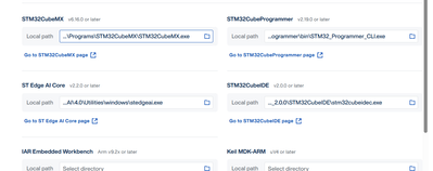

Could you share the versions of the other programs you are running? You can find the recommended versions under the Settings tab on the left.

Here are the versions am using,
C:\ST\STM32CubeIDE_2.0.0\STM32CubeIDE\stm32cubeidec.exe
C:\ST\STEdgeAI\4.0\Utilities\windows
C:\Program Files\STMicroelectronics\STM32Cube\STM32CubeProgrammer\bin -> 2.22.0
C:\Users\jorda\AppData\Local\Programs\STM32CubeMX -> 6.17.0
2026-05-26 1:02 AM
