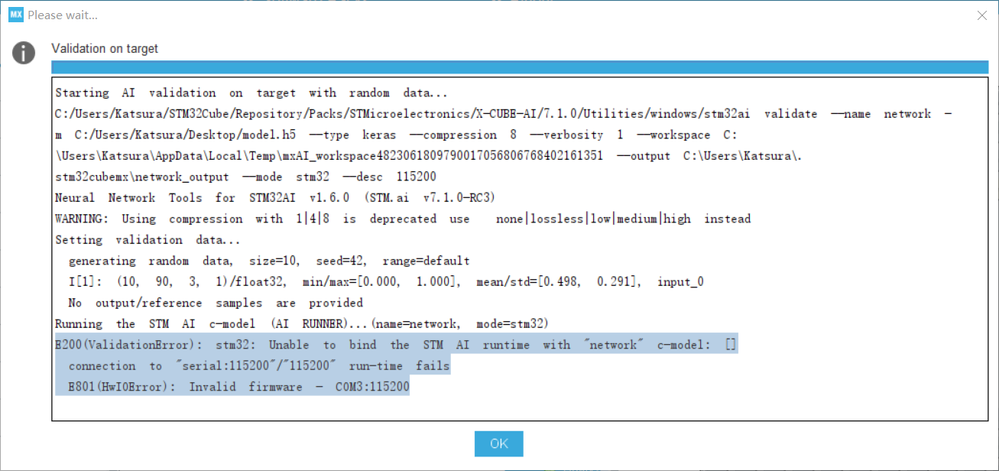

Hi, it seems to be a common error in STM32 devices. It happens when I try to validate on target after analyze the model. I tried to fix it according to the answers in community. But those solutions given in community or other websites doesn't help. At least for my board they doesn't help.0693W00000Nqn06QAB.png

ST-Link connectivity works normally. (Able to connect with CubeProgrammer).
It can be built in Keil and could be load to the board, with LD6 blinking in red and green. I am looking forward to solutions to this problem.
