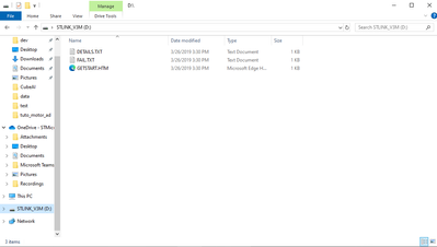

The easiest way to log data via USB with a proteus is to use the datalogger tool in NanoEdge:
* Open NanoEdge And go to the datalogger from the main page
* Select the Proteus, the accelerometer that you want to use and the parameters (buffer size, sampling rate):
* Click generate data logger
* Drag and drop the binary file to flash it (you need a ST link)
You are can then import data in NanoEdge via serial.

You need to use the provided scripts to get data via serial

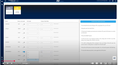

I am also looking for the version 3.01 as this youtube video ST Microelectronics shows that the nano edge had 'Connect & Flash ' and 'Configure Datalogger'  features that we do not find on version 5.0 now?
https://www.youtube.com/watch?v=yXMUv_C5FGk
Hello @Amiyou,
This feature is not available anymore.
It was replaced by the Datalogger generator.
You also need to manually flash it.
Have a good day,
Julian
