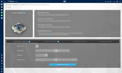

I can also suggest looking at the available data logger and the sensors in NanoEdge AI Studio, find something that suits you need, get the corresponding board and use the data logger code to create a project.
In the linked github, you will find the source code to read data of the selected sensor and send the data via serial: https://github.com/stm32-hotspot/stm32ai-nanoedge-datalogger/
Example:
STEVAL-STWINKT1B with ISM330DHCX accelerometer (source code on the github)
Once you have a CubeIDE project and you are able to send data coming from your sensor via serial, using a NanoEdge AI Library is pretty easy. The process is very similar for the 4 kinds of project in NanoEdge. Here I will explain the N class classification as it is your question:

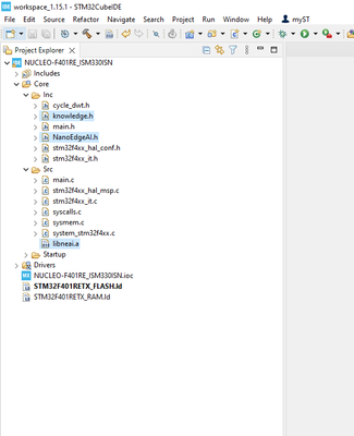

NanoEdge AI Library Integration:
In the last step of NanoEdge, you will compile your library and get a .zip file that contains:
- (Arduino file if compiling for an Arduino target)
- A Docs folder with link to the documentation
- A Emulator folder to run the model on your pc with command lines
- knowledge.h: the weight of the model
- libneai.a: the compiled library
- metadata.json
- NanoEdgeAI.h: the function header and variable to use in your main.c
The files that you need are in bold.

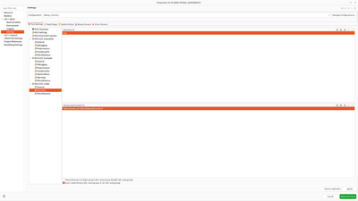

Open your STM32CubeIDE project and import knowledge.h, libneai.a and NanoEdgeAI.h. Generally, you want to had knowledge.h and NanoEdge.h in the Inc folder and the libneai.a in the src folder. Like this:
Make sure that the path to the libneai is set:
- right click on your project > properties > Settings > MCU GCC Linker and add the path if not set
Once you have that, you can add the code in your main.c to use the NanoEdge Library:

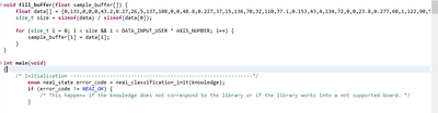

Initialize the model:
neai_state = neai_classification_init(knowledge);
printf("Initialize NEAI library. NEAI init return: %d.\n", neai_state);();
NEAI_OK
: the library is working as expectedNEAI_INIT_FCT_NOT_CALLED
: the learn or detect function has been called without running the init function before. Initialize your library.NEAI_BOARD_ERROR
: the board detected is not authorized. For instance, it may happen if you are trying to use a library (for instance obtained from the free version of NanoEdge AI Studio) with a non-supported board.NEAI_KNOWLEDGE_BUFFER_ERROR
: the knowledge loaded is not compatible with this library. Make sure that the knowledge being used is the one obtained with this exact library.NEAI_NOT_ENOUGH_CALL_TO_LEARNING
: this is a fail-safe to prevent users from running an insufficient (only one or a few) number of iterations of the learning function. Run more learning iterations.NEAI_UNKNOWN_ERROR
: there is an unknown error with the library.
It should return NEAI_OK.
Then to use the model and do the classification and print the detected class, here is what you need to do:
neai_state = neai_classification(input_user_buffer, output_class_buffer, &id_class);
// you can print id2class[id_class] to get the predicted class
// you can also look at the output_class_buffer to get the probability of your signal to be of each class

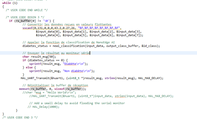

‎2024-07-22 1:29 AM
hello . thank you for your help.
is this code correct?
‎2024-07-22 3:09 AM
I believe that your rx_buffer contains the value that you want to use for the classification:
What does your rx_buffer look like?
- if it looks like this: "0,1, 2, 3, 4, 5, 6, 7", then the code for your sscanf should look like this:
sscanf("0,1,2,3,4,5,6,7", "%f,%f,%f,%f,%f,%f,%f,%f", &input_data[0],&input_data[1],&input_data[2],&input_data[3],&input_data[4],&input_data[5],&input_data[6],&input_data[7]);
- If it looks like this: "0 1 2 3 4 5 6 7", then your sscanf should look like this:4
sscanf("0 1 2 3 4 5 6 7", "%f %f %f %f %f %f %f %f", &input_data[0],&input_data[1],&input_data[2],&input_data[3],&input_data[4],&input_data[5],&input_data[6],&input_data[7]);
You can put the rx_buffer directly in the sscanf.
Then, you also have an issue with the classification. The result of the classification is not diabetes_status (it only returns a neai_state, look at my previous message). The result of the classification is id_class, so you need to have something like this:
if (&id_class == 0){
sprintf(result_msg, "Diabetes\r\n");
} else{
sprintf(result_msg, "Non-diabetes\r\n");

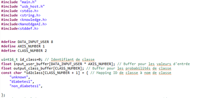

‎2024-07-23 2:25 AM
Hello, thank you very much for your support and help
i change my code like this :
this image for declaartion
this for uart :
and this is the main code in boucle while(1) :
and this exemple for my data :
I have 8 axes and each axis has 32 values ​​in the line:
my biggest probleme now is how i put my data in the input_user_buffer and how i scan this input anf finnaly how in tera term i see is diabetes or non_diabetes

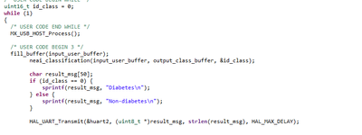

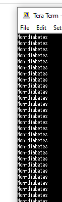

‎2024-07-23 6:34 AM
hello . i use this code
but always the same display whatever the data
‎2024-07-23 7:58 AM
I did make a mistake in my last message. The condition "&id_class == 0" is false. The id_class 0 correspond to unknown. the condition should test if the model is returning either 1 or 2 for the class Diabetes or Not diabetes:
if (&id_class == 1){
} else{
It should solve your issue.
If you have any other question related to NanoEdge, I will gladly help you but if your question is about UART, reading data, printing data or any related topics, I will ask you to first look online, there are plenty of content to explain these kinds of things. You also have chatGPT that is very good at handling basic topics like these and if you still struggle, then please create a new post on the right related ST community.
Have a good day!
Julian
