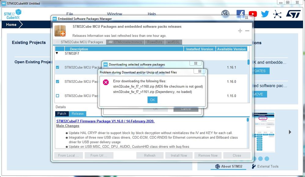

Error in downloading stm32cube_fw_f7_v1160.zip
AS.4
I am trying to use the STM AI by following the instructions in this document.
I get the above mentioned error while trying to download it from the CubeMX.
I tried downloading it from this website and it simple does not start downloading.
I tried downloading it from its Github repository and it gives a network error.
Could you please let me know how to resolve this issue?
Thank you.

This problem still exist, i changed proxy configuration and checked credentials more than one time..
These are the phases i see:
1) the download proceed correctly until the end (1239MBytes)
2) Unzip File: stm32cube_fw_v1160.zip
3) Connection to HTTP Server ...
4) ERROR downloading the following files:
stm32cube_fw_f7_v1161.zip (Timeout during download)
Since the first zip has been downloaded correctly i think is not proxy or my fault.
ST has historically had issues with files >1GB, for reasons that are particularly clear, and they provide three different sources to pull files from.
I've also found proxies can also be unreliable, especially if not maintained.
Perhaps you can download the files manually, from the Cube F7 pages, and then "Install from Local"
The sub-versions may be patches applied to the major versions. Make sure to install v1.16.0 first, and then do the incremental.

I'm trying to follow your guideline, the base version 11.6.0 is done, then downloading the patch from Cube F7 page, but do not work properly anyway installing from local with the downloaded patch..
Why the version of the Firmware used is directly associated to the version of the CubeMX? There's the possibility to migrate to a different version of the project and not simply "the last one associated to the current version of your CubeMX"?
I'm now trying to downgrade to CubeMX 6.2.0 and use the second last version of the F7 FW, since is the CubeMX 6.2.1 that is associated to the 16.1 FW release

Forced it to reapply, and it looked to process the 1.16.0 ZIP again, and then apply the 1.16.1
I have initially tried from a fresh install, and checked both 1.16.x packages for install, and clicked Install Now
Second pass the 1.16.0 was flagged as installed, and I checked 1.16.1 again, and then installed.
Hi again,
I was able to reproduce problem, it's not a systematic issue.. now, it's under analysis and it will be fixed.
Thanks for raising the point.
