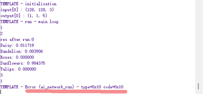

Error code from cube ai 8.1.0
123456dad

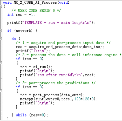

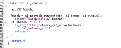

I meet that when follow func is in its second  loop
And I find the value of var 'batch' is not 1 in the second loop,Why?
123456dad
uh..... I fixed many problems by update my Keil MDK...............................
