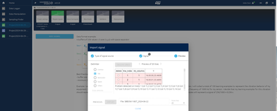

这是我想导入的数据集,希望模型能起到这样的效果:文档中是各个时间点的温度值,我需要模型能学习一天中的温度变化范围,当温度偏离较大时检测为异常,请问我在导入数据时,为何显示无法import?(Import按钮是灰色的,无法点击)

Hello @theshy ,
Thank you for reaching out,
In your first line you have 16.00.00 , 33.4608
I believe that what you want to import is the 33.4608, the other values look like timestamps. If they are, please remove them.
If you indeed want to import both values, you may want to convert the 16.00.00 to a value with only one dot. if the value is a timestamp, you can try to convert the value to seconds for example.
