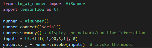

I'm trying to send data and retrieve the output from my stm32f4-DISCO. I'm using a python based code and specifically stm_ai_runner. The code is rather simpler but I can't access the board because even runner.summary() doesn't work. My board is flashed with the network :
0693W00000QKrV1QAL.pngAnd this is what my code looks like :
0693W00000QKrVzQAL.pngAnd the terminal :
0693W00000QKrWJQA1.pngI thank you in advance,
Numa
NBlan.1
I successfully manage to fix the problem, sorry, It was a simple wire pronlem (he was in a bad shape) thanks you so much for your time. Have a nice day.

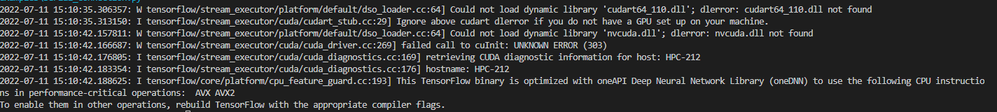

fauvarque.daniel
the tensorflow messages that you are seeing are because you don't have a NVIDIA graphics card on your machine. To get rid of those messages you can perform:
pip install tensorflow-cpu==2.9.0
of course the version of tensorflow-cpu must correspond to the version of tensorflow you have on the machine.
Also Tensorflow requires AVX2 enabled CPU, if you have an old machine with AVX2 not supported, tensorflow won't work

you can use the "mode" command to see all the available ports.
Normally it scans all the ports until there is one responding as the target will answer.
you can specify explicitly the com port to use by passing serial:COM6:115200 instead of serial
from stm_ai_runner import AiRunner
runner = AiRunner()
runner.connect('serial:COM6:115200')
runner.connect returns true if the connection is sucessfull.
You can also hit the reset button on the board before to launch the python code
Regards
Daniel

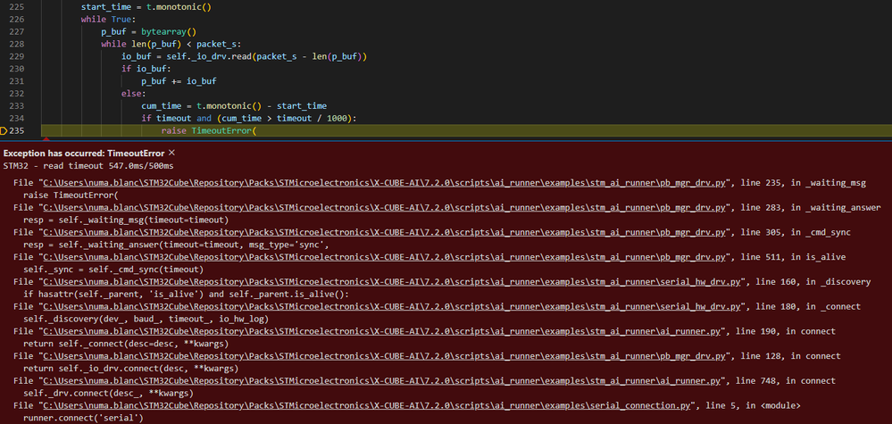

Hello Daniel,
There is some news, I changed my keras model into a tflite model and visibly He now tries to connect. When I do what you said about specify explicitly the COM port like so :
runner = AiRunner()
runner.summary() # display the network/run-time information
inputs = tf.fill([1,96,96,1], 0)
outputs, _ = runner.invoke(inputs)  # invoke the model
I get this error message :

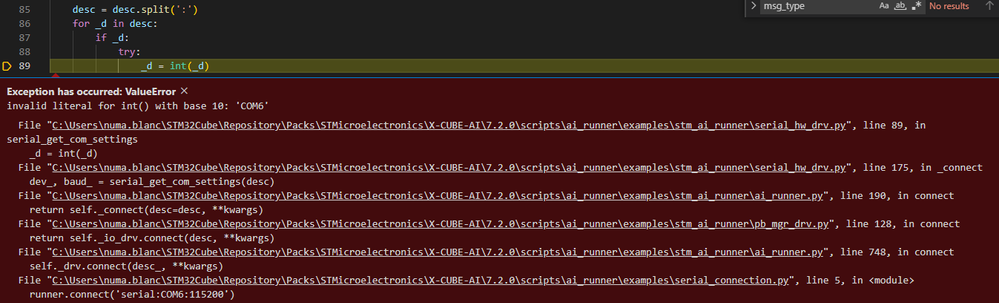

0693W00000QKv94QAD.pngAnd when I try to just put :
if runner.connect('serial'):
I get this error :
0693W00000QKv9xQAD.pngSo it seems to try to connect but doesn't seem to success...
Even when I change the port- default value in "serial_hw_drv.py" like so :
# default values
    port_ = 'COM6'
    baud_ = int(115200)
I get the same error, do you know why ?

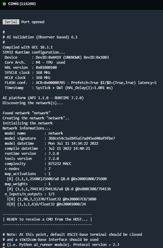

What about the stm32ai validate command on the target ? does it completes the validation ?
~/STM32Cube/Repository/Packs/STMicroelectronics/X-CUBE-AI/7.2.0/Utilities/windows/stm32ai validate -m model.tflite --target stm32
The command create a report file and seems te work. Except that the accuracy is "n.a" and most importantly if I unplug my board it's working, so I think it's more of a "validate on host".
Avout the python code, the problem must be from the board because when I try with another board (I used a H747) it worked as intented.
Maybe the problem is that the stm32f4-DISCO don't have a virtual port COM so I use a FTDI as a Serial Port COM. Do I need to do some kin of manipulation to work via the FTDI ?
Best regard,
Numa
