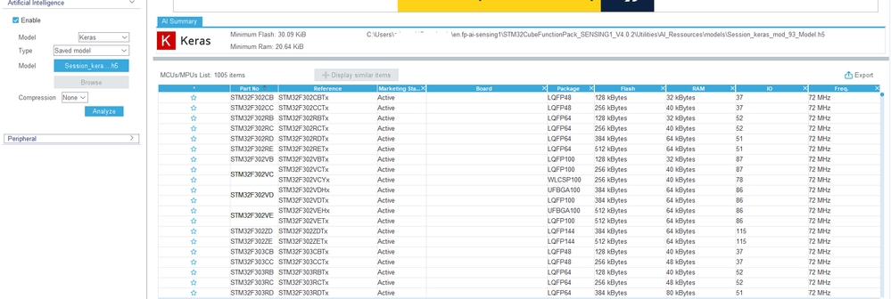

hi, thanks for the reply.
I have uninstalled and re-installed again. While uploading my .h5 file am getting error. My file is not getting analyzed.
can you check?
I tried to upload the sample model from FP-AI-Sensing Pack-"Session_keras_mod_93_Model.h5 file"
Hi @ShivaRagu​ ,
Let me share with you my comprehension to avoid any misunderstanding: so, you have downloaded FP-AI-SENSING1 pack and you browse the Session_keras_mod_93_Model.h5 keras model after enabling the Artificial Intelligence search criteria in the MCU selector tab. Did I correctly reproduce your scenario?
Actually, following the steps above, no error window is displayed and the file is analyzed without any problem:
Could you please precise which CubeMX version are you using ?
Also, you can attach your log files under: <USER_HOME>\.stm32cubemx\STM32CubeMX.log and <USER_HOME>\.stmcufinder\STMCUFinder.log. They may revel the root cause of this misbehavior.
Thanks in advance.
Khouloud.
Hi Gm,
I installed the latest version of stm32cubemx V 6.2.0 and also enabled the AI (latest version). I don't know why am getting error while uploading .h5 file.
Am not able to analyze the model. Is there any version problem in mx. May be if i try some older version will it work?
