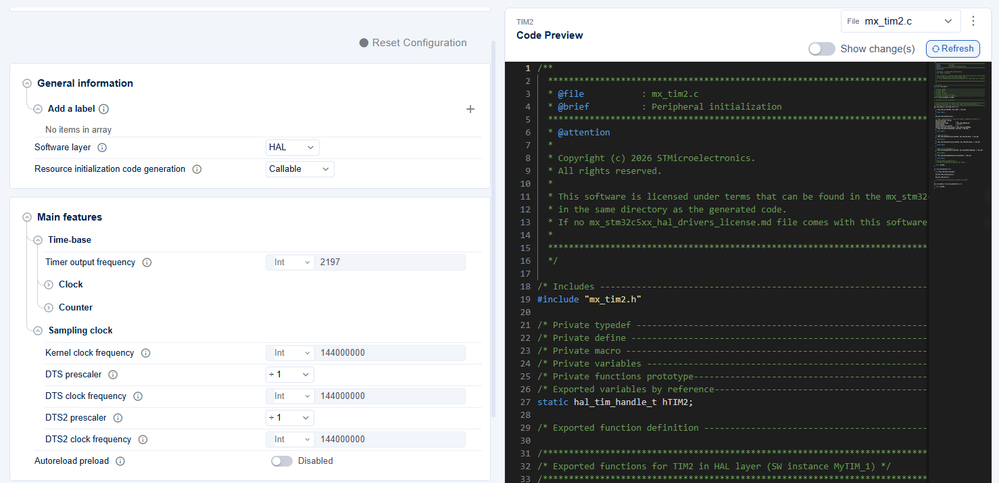

live code preview for faster prototyping
The new live code preview in STM32CubeMX2 accelerates prototyping for developers who use STM32CubeMX as a code snippet generator:
  • No need to generate full projects
    Get the initialization code directly in the STM32CubeMX2 live code preview window, ready to paste into your existing project.
  • Instant feedback
    Any change in the configurator is immediately reflected in the code preview, so you can track updates in real time.
  • Diff view for clearer understanding
    A built-in diff function shows how configuration changes impact the generated code, helping you understand updates at a glance.

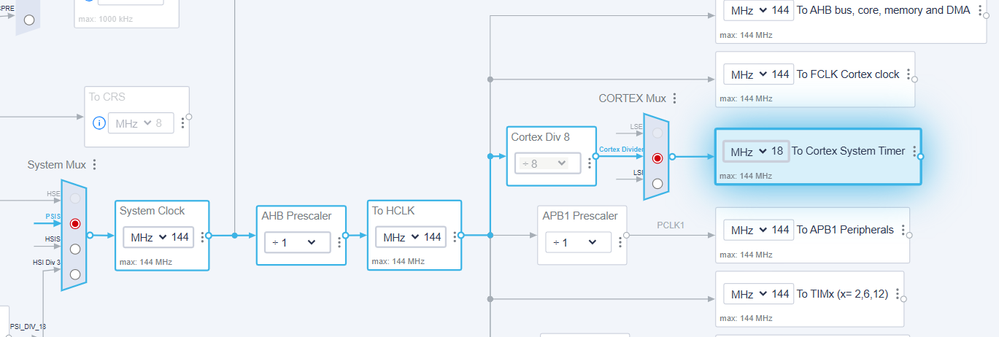

Highlight Path: clearer clock configuration
Tracing clock signals with your finger on the screen is no longer necessary. In STM32CubeMX2, the Highlight Path feature shows:
  • Which peripherals depend on a given clock
  • Which clock a specific peripheral is running on
In addition, a new table view provides a simple, organized display of all clocks, making it much easier to understand and manage your clock configuration.

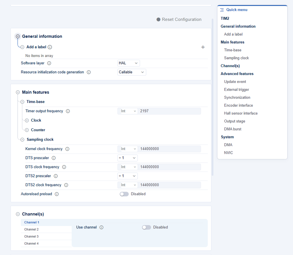

Pinout table view for faster, clearer configuration
On the configuration side, the new pinout experience boosts productivity with:
  • Enhanced pin search
  • Clear highlighting of alternative pins for a given I/O
  • A table view that makes assignments easier to review and adjust
These improvements help shorten time to market while keeping project dependencies and configuration under control. The optimized graphical interface makes it easier to identify the right pin for your design, enabling hardware and software teams to collaborate more efficiently and get projects ready faster.
GUI updates for a smoother experience
The new and enhanced user interface is designed to make your workflow more intuitive and efficient. By prioritizing easy access to the most frequently used and straightforward settings, it streamlines the journey from concept or datasheet to a working prototype—so you can focus on what matters most.
With a new quick menu, you’ll never miss an important setting. It ensures you can always find what you’re looking for, even when navigating more complex features, making your workflow smoother and more efficient.

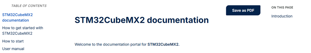

STM32CubeMX2 documentation goes online
Instead of relying on static PDF files, STM32CubeMX2 now features a brand-new online documentation portal, ensuring you always have access to the latest, most up-to-date information.
The portal also provides direct links to articles, application notes, and related resources, helping you achieve more in less time.
