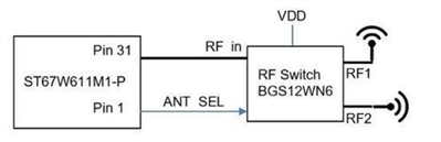

  • The solution combines simplicity and power by using RX Diversity with two antennas placed in different configurations, such as orthogonally.
  • A built-in intelligent algorithm operates in real-time during the packet’s preamble, measuring the RSSI (Received Signal Strength Indicator) from both antennas.
  • Based on these measurements, the algorithm instantly selects the antenna receiving the strongest signal to receive the remainder of the packet.
  • This automatic antenna selection ensures that the device consistently uses the best signal path, significantly enhancing link stability and throughput, especially in challenging locations.

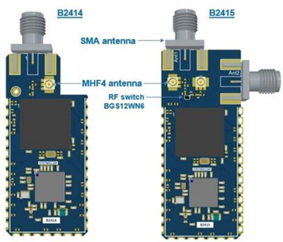

Get started with new reference designs
To help you accelerate your development and evaluate this new feature, we have two new reference designs ready:
  1. B2414 board: This board is your go-to for standard applications featuring a single antenna path
  1. B2415 board: This board is specifically designed to leverage the new RX diversity feature, providing a two-antenna path for full evaluation and implementation.
The new ST67W611M1A6P module and these reference designs give you the power to create next generation connected devices that maintain performance even when the signal environment is less than ideal.
