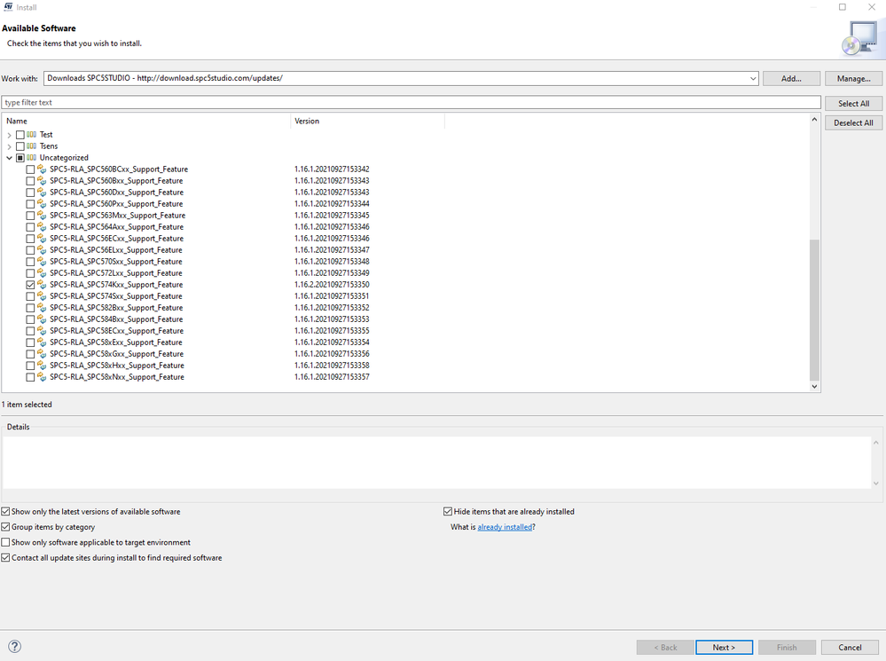

Hi all, I got back on a project on the SPC574K2 I paused a few months ago and decided to start over from a green-field environment.
I then downloaded and installed SPC5Studio 6.0.0 Doyle which came along with version 1.16.1.20210914101245 of the LLD sdk.
Unfortunately my project builds fine but it is not running anymore due to a problem in board clock management (I', using the EVBoard)
To have proof of evidence for this I re-installed 6.0.0.Asimov (which instead comes with LLD version 1.13.1.20200626121018 with which, instead, my code (AND the EXAMPLES provided by ST) builds and runs just fine
Needless to say I'm pretty unhappy of this finding which came out without any explicit notice >:(
Has anyone run into similar issues? how did you got away?
Thanks in advance
    Best answer by Erwan YVIN
    Hello CoolMo,
    Update on SPC574K2 RLA has been pushed in http://download.spc5studio.com/updates
    You can update only the following feature
    SPC5-RLA_SPC574Kxx_Support_Feature 1.16.2
    0693W00000FCcoXQAT.pngSorry for the issue ;)
    Best Regards
    Erwan

    Erwan YVIN
    Erwan YVINBest answer
    October 15, 2021
    Hello CoolMo,
    Best Regards
    Erwan

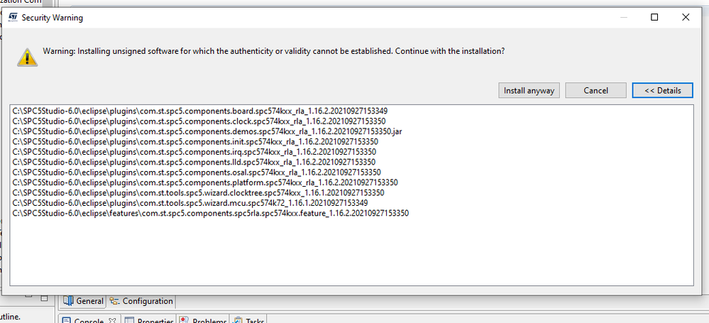

    CoolMo
    CoolMoAuthor
    October 15, 2021
    Yes, I can confirm the examples now work with 1.16.2.
    Thank you for prompt and quick acting.
    one last thing: signing of plugin may need to be included for next releases (install anyway is possible and things work afterwards):
    0693W00000FCeDxQAL.pngThanks again
    Mo
    Erwan YVIN
    October 15, 2021
    Hello CoolMo ,
    We need to create a real signature in our next delivery workbench. (features & plugins)
    you can click on "Install Anyway"
    it is a change request in our process ;)
    Best Regards
    Erwan
