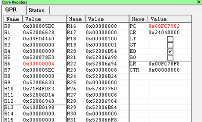

I am currently developing with SPC5STUDIO and want to verify a signed message using ECDSA.
To do this, I am studying the example in ecc.h.
When I ran the example code:
retval = ECCinitEC(&ECparams, &mb);
retval = ECCinitPoint(&G, &ECparams, &mb);
retval = ECCsetPointGenerator(G, &ECparams);
retval = ECCinitPoint(&PubKey, &ECparams, &mb);
retval = ECCinitPrivKey(&privkey, &ECparams, &mb);
retval = ECCsetPrivKeyValue(privkey, ecc_160_privkey, sizeof(ecc_160_privkey));
These functions executed without any issues, and I confirmed that the keys and parameters were correctly set in each variable.

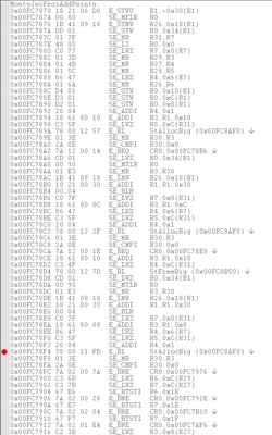

However, when I call the function retval = ECCscalarMul(G, privkey, PubKey, &ECparams, &mb);, the system stops working and crashes.
If you have any insights or comments on this issue, I would greatly appreciate it.

Hello ,
i recommend to check the PC, R14, R13 with your debugger
Maybe it is a stack pointer overflow
     Best regards
                 Erwan
August 14, 2024
Thank you for your response. Are PC, R13, and R14 referring to core registers? If so, what are these registers specifically, and what should I be checking in each of them? If it turns out that stack pointer overflow is indeed the issue, how can I resolve the problem? Thank you.
