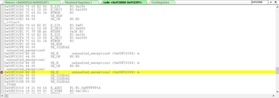

Hello Erwan,
Thank you for your answer.

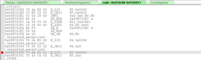

According to your answer, when I turned on the device, the device locked at the point in the image.
Can you help me with the solution?

Hello ,
it is a data abort ..check R13, R14 with your debugger
it will point where the data abort happenned.

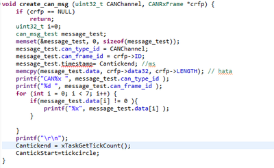

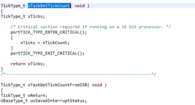

But the "xTaskGetTickCount" function I use to create a timestamp for the data causes a crash.
When I turn off this function in its software and activate the TCP part, it crashes again.
The part where I use the function is listed below.
