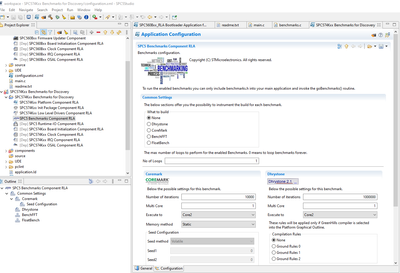

SPC57K-Discovery Debug download SPC574Kxx Benchmarks for Discovery
Using the on-board emulator, how to download the SPC574Kxx performance metrics evaluation program to ... inside the SPC 57k- found and run it, please help provide specific debugging steps.

Hello ,
Better to use PLS UDE to flash the software
and put the UART to 38400
you can configure Benchmarks modules in SPC5Studio Tools suite :
              Best Regards
                                Erwan
