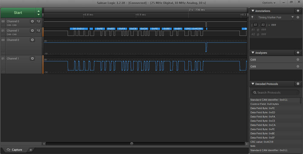

I am trying to initialize BAF on microcontroller SPC5 using SPC5 connect and SPC5 flash programmer. When I try to connect it I get the following error:
[2019/04/30 10:12:19]: SPC5 Flash Programmer 2.7.1 - Start connection: Target:SPC58EC70 - External crystal: 16MHz - Interface: UCCAN::SPC5Connect/0/CAN
[2019/04/30 10:12:22]: An error occured during plugin downloading via BAM/BAF
[2019/04/30 10:12:22]: Connection end.
I monitored the communication channel and got the following results:
It seems the device is sending the password several times. I also checked the microcontroller registers and in the PSR[LEC] register from CAN Channel I got a value refering to BIT0 error code.
Does anybody know what the problem is? How can I solve it?
