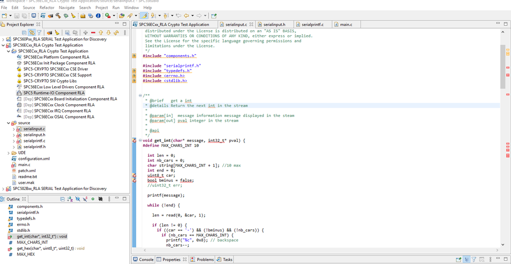

    Best answer by Erwan YVIN
    Hello ,
    Sorry for the late answer ;)
    Good to see that your have solved your issue.
    Adapt the driver is a good choice.
    For the big project relative to collect some data coming from UART. (Near-space balloon, Automotive project and so on ..)
    we are using :
    • Chibios / FreeRTOS threads to save CPU
    • some functions serial_input.c / .h with Runtime Components (cf Screenshot)
    Best Regards
    Erwan
