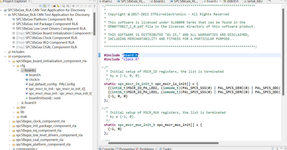

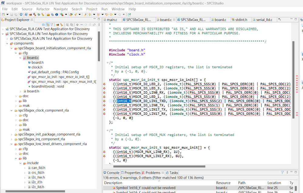

I am developing Lin function(UART) for SPC58eg in SPC5Studio.
I cannot build the project of the title because the project cannot  be included stdint.h file in SPC5Stusio.
However, I can build the Can Test Application and it includes stdint.h.
How can I fix the error?

Best answer by Erwan YVIN
Hello Fukai ,
it is just CDT Settings
Cf link here
https://community.st.com/t5/microcontrollers/i-have-installed-spc5-studio-version-6-0-on-my-windows-10-pc-and/td-p/152921
    Best Regards
                      Erwan
