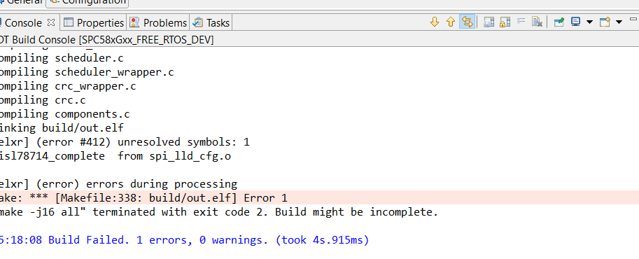

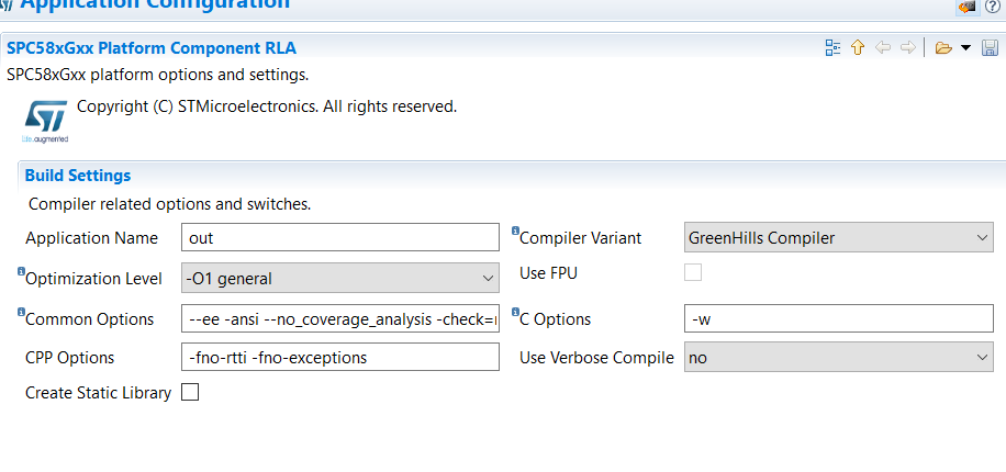

I am attempting to get the GHS compilier to build with SPC58NG dev kit and have switched the Build settings to below
 0693W00000BcE2fQAF.pngI have updated the project to include the path and commented out the error statement
ifeq ($(GHS_PATH),)
export PATH := C:\ghs\comp_202114\$(PATH_SEPARATOR)${PATH}
 # $(error Please specify a valid path into GHS_PATH for ccppc (GHS) compiler)
endif
and it will compile but then include some strange error that doesn't really help. Is there any setting I need to fix it looks to be something in the linking process.
    Says the linker failed because it can't find a symbol/function to bind with.
    Either you're missing a source, or object file, or you have some #ifdef level exclusion of code you actually need, but isn't supplied for the GHS tools.
    Perhaps start by figuring out what symbol it is choking on, a partial .MAP or linker output? Increase verbosity level if appropriate.
    NMazz.2
    NMazz.2Author
    Jun 29, 2021 3:12 PM UTC
    Yeah okay it was missing a callback that didnt bother gcc.
    On another note every time I regenerate something, the makefile gets regenerated and I have to rewrite the fix in the makefile.
    I have added ghs to my path variables on my machine and also in the project. Any work arounds for this?
    ifeq ($(GHS_PATH),)
    endif
    Tesla DeLorean
    Tesla DeLoreanBest answer
    Guru
    Jul 2, 2024 3:43 PM UTC
    TBH this looks circular, adding to the PATH for executables / tools
    Surely you want to be exporting GHS_PATH, not PATH, as presumable used elsewhere in the scripting or INCLUDE / LIB paths, etc. Or that GHS_PATH exists from the outset in your installed environment.
    Erwan YVIN
    Jul 10, 2024 9:34 AM UTC
    Yes , it is in Windows Preferences , you should add the GHS_PATH in your environment ;)
