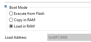

    ODOUV.1
    January 31, 2022
    Could you try this Load in RAM configuration ? (in SPC58xGxx RLA Platfrom->runtime settings)0693W00000JNilIQAT.png
    BRs,
    -Olivier
    DMA
    DMAAuthor
    January 31, 2022
    Hi Oliver,
    I tried using this setting but same result is observed. I am not able to erase the memory.
    I also tried different memory blocks(0x01000000 and 0x01020000) but still not working and control got stuck in unhandled exception.
    Thanks and Regards
    Deepesh
